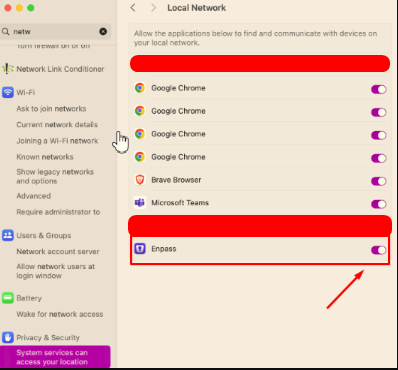

Posted
It seems the problem is related to the "Local Network Privacy" permission settings introduced in recent versions of macOS and iOS.
To resolve this, please follow the steps below:
Enable Local Network Access
For macOS:
  1. Open System Settings > Privacy & Security > Local Network.
  2. Locate Enpass in the list and enable access.
  3. Restart the Wi-Fi sync server and Enpass app.
For iOS:
  1. Go to Settings > Privacy > Local Network.
  2. Find Enpass and toggle access to "On."
  3. Restart the Enpass app
Once done, try syncing again using Wi-Fi sync to verify if the issue is resolved.
Posted
Thanks, but this doesn't work. My Privacy & Security settings are as shown above. I turned off and restarted the Wi-fi Sync Server on my Mac (OS 15.1.1) and then watched the Synchronizing icon for 10 minutes before it quit and showed this familiar message. image.png.0855f1e935f4b0e9b7b0793f3670d2e9.png
Then, as I have done many times before, I deleted Enpass from my iPad (IOS 18.1.1) and reinstalled it. As expected, it instantly synchronized a test entry, and it will likely continue to sync for hours or even a day or two, before failing again.
I have begun adding passwords to the new Apple Password Manager, as the Enpass issue is now over two years old. I will continue using Enpass as long as I don't add new entries. But I think it's only a matter of time before I abandon the app.
