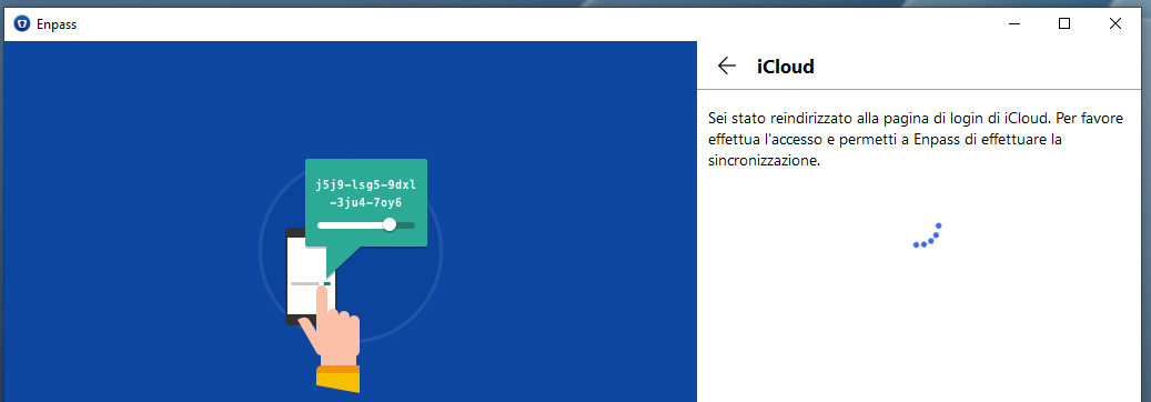

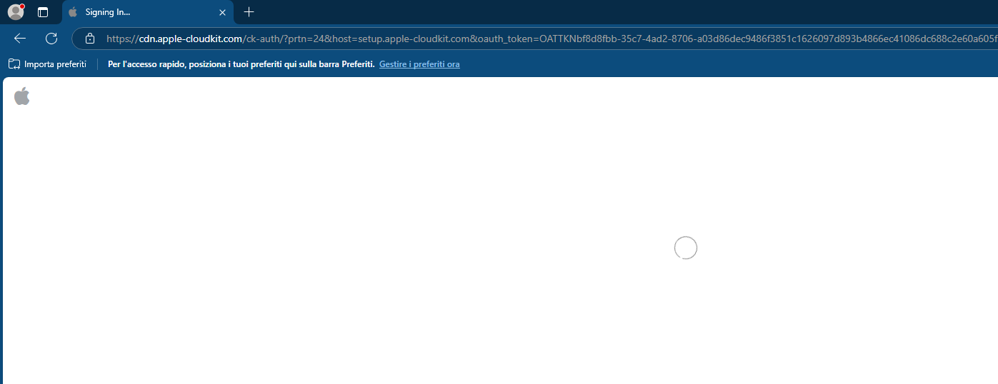

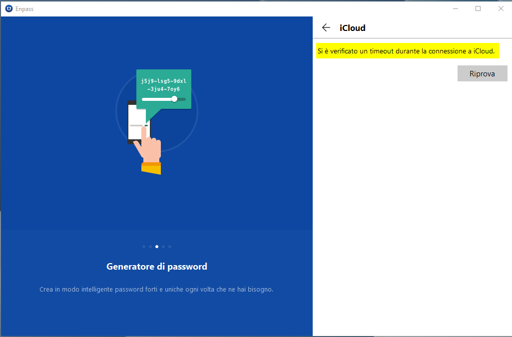

Andrea Vannini Posted March 26 Report Posted March 26 Good morning, For the past few weeks, iCloud synchronization has not been working on one of my Windows 10 PCs. I get a timeout error after signing in with my Apple ID and waiting for some minutes. I have tried signing in using both Chrome and Edge. See attached images. I also tried uninstalling and reinstalling Enpass, but that didn’t solve the issue. I have another Windows 10 PC that syncs correctly. My iPhone also syncs correctly. Can you help me? Thanks!

Andrea Vannini Posted March 27 Report Posted March 27 20 hours ago, AnakinCaesar said: Please try authenticating with Firefox. Other users reported the same issue and solved it with using Firefox. https://discussion.enpass.io/index.php?/topic/31671-icloud-sync-is-broken/ Confirmed!!! I tried with Firefox and solved it! Thank you very much!
