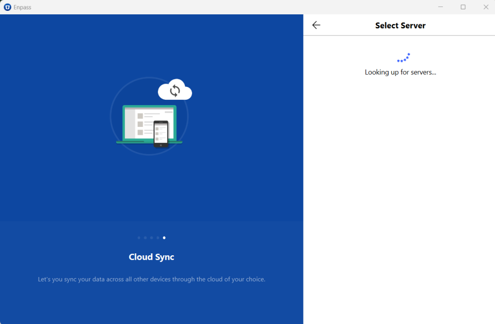

When I install enpass on my Windows 11 laptop and select Wi-Fi Sync the application just spins and says "Looking up for servers..."  Both systems are on the same private network.

I've upgraded to the latest version of Enpass and this is still outstanding on my Windows 11 laptop.  Do you have any additional info?  This has been outstanding for a very long time.
Here are the details of my setup and what I’ve tried:
  • Server: Windows 11 desktop, Enpass Wi-Fi Sync Server running, network profile set to Private
  • Client: Windows 11 laptop, same Wi-Fi network, network profile also set to Private
  • VPN: NordVPN is disabled on both systems
  • Firewall: Windows Defender Firewall disabled on both systems during testing
  • Connectivity: Laptop can ping the desktop successfully
  • Browser test: Entering https://192.168.1.100:58529 from my Windows 11 laptop prompts for username/password, confirming HTTPS server is reachable
    • I get a message saying my connection isn't private. Also I get a message warning about the security certificate. I think this is normal behavior for local services that aren’t backed by a public certificate
  • Enpass behavior: Laptop client never discovers the server, does not offer QR code scan or manual IP entry

This seems like a client-side bug or sync module failure.  Could you advise on any additional diagnostics or configuration steps to resolve this?
