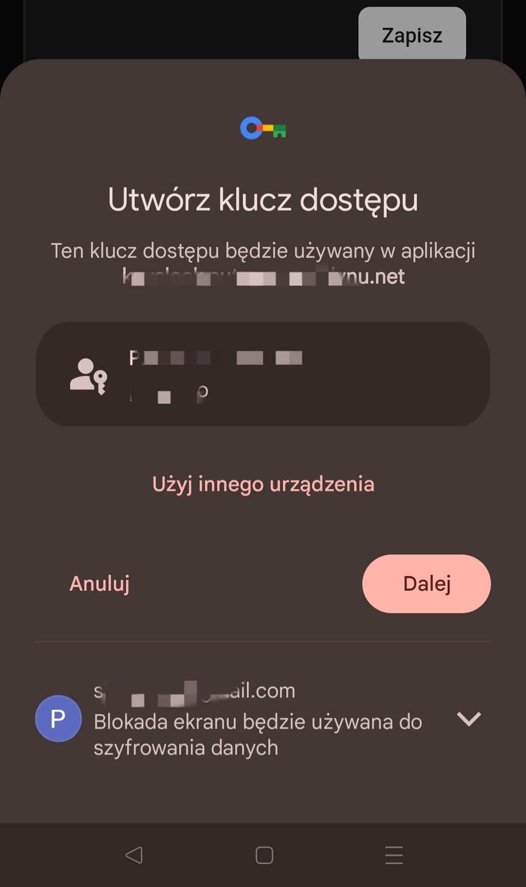

Hello, thanks for Your help. Thanks to You I open my pocketID admin page in smartphone browser and then add new passkey. Then Google password manager save that passkey. Now I can use it. But Enpass don't show as option. I can use passkey from Enpass only in browser on desktop. As You can see on second screenshot I set Enpass as default option for auto fill.

Hi, as I said above I have Enpass selected as auto fill default option. When I login in my pocketID admin page and generate new passkey I have only Google option.
