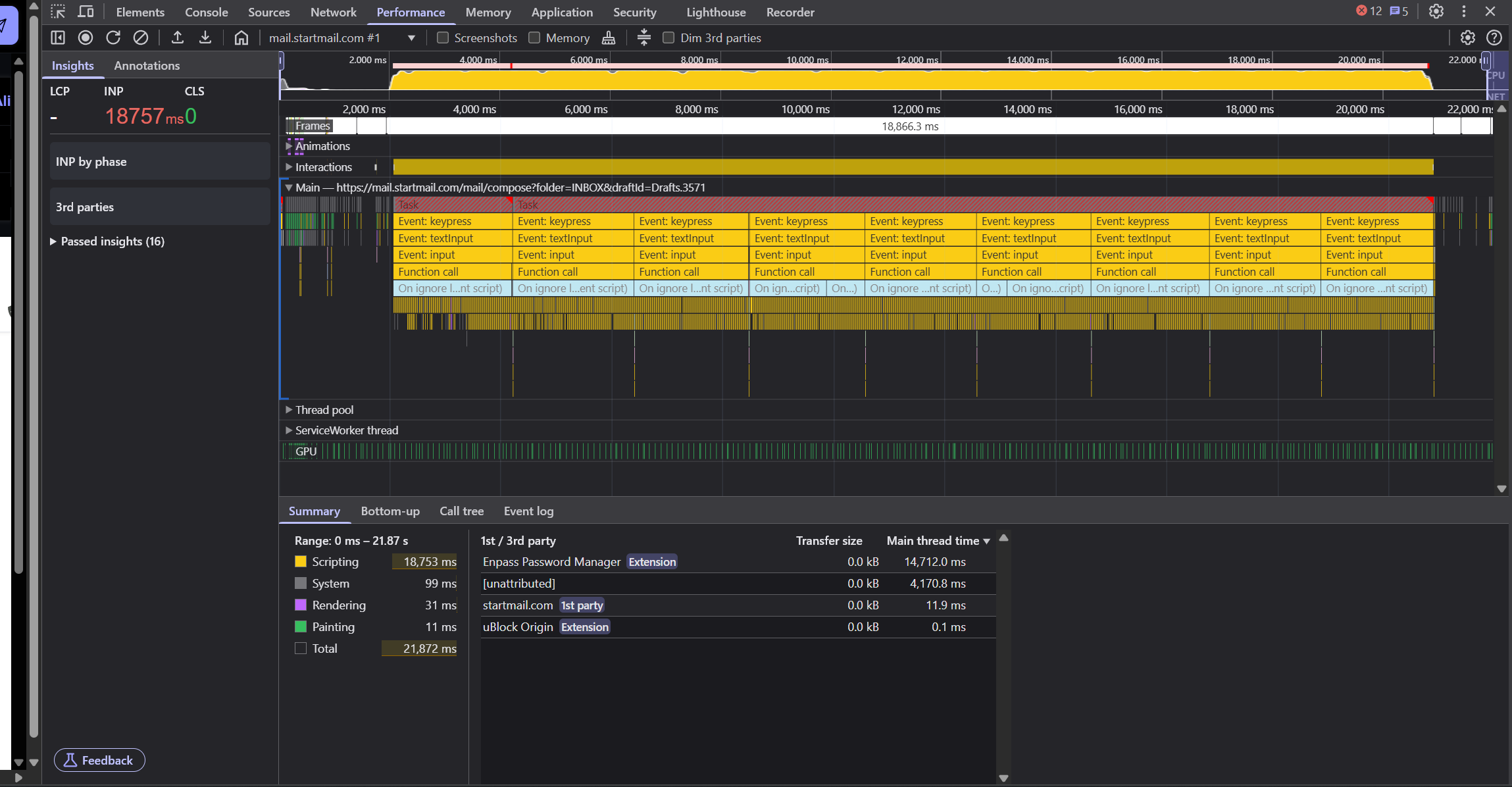

for a few months now, I am unable to use Startmail's web mailer. When trying to write an e-mail, text input lags by up to 20s (!), meaning I type a character or word and they would only appear 15-20 seconds later.
When looking at the DevTools, it's clearly visible Enpass is the cause. I don't have the problem on any other website. Disabling the extension immediately fixes the problem.
