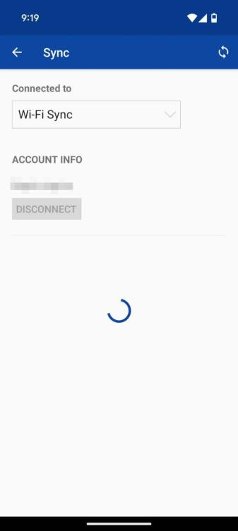

justaguy Posted August 11, 2025 Report Posted August 11, 2025 Once you set up Wi-Fi sync on Enpass Android, it's impossible to change any sync feature if it can't connect. The wifi sync is very finnicky and doesn't work most of time, so I end up with this screen with everything greyed out and unchangeable: Nothing on this screen can be tapped, everything is just stuck and unchangeable. So it's impossible to change syncing once it's set up and can't connect. Can you please provide a solution or ideally fix this issue so that users can disconnect and/or cancel the operation? This behavior is very frustrating for the user, as we're stuck and unable to do anything. Thank you.

justaguy Posted August 12, 2025 Author Report Posted August 12, 2025 Can you please offer a workaround in the meanwhile? I really need to sync my computer and phone but I can't change any sync settings on my phone because of this problem. I'm completely stuck, short of uninstalling enpass and setting it up again from scratch.

Tarun Singh Rawat Posted August 26, 2025 Report Posted August 26, 2025 To help resolve the issue with the stuck vault, please follow the steps below: Turn off your internet connection (or enable flight mode) on your device. Close the Enpass app completely and remove it from recent apps. Reopen Enpass. Navigate to the vault that appears to be stuck. Tap Disconnect to remove the Wi-Fi Sync setup.
justaguy Posted September 11, 2025 Author Report Posted September 11, 2025 On 8/26/2025 at 8:26 AM, Tarun Singh Rawat said: To help resolve the issue with the stuck vault, please follow the steps below: Turn off your internet connection (or enable flight mode) on your device. Close the Enpass app completely and remove it from recent apps. Reopen Enpass. Navigate to the vault that appears to be stuck. Tap Disconnect to remove the Wi-Fi Sync setup. I tried this and it worked, thanks. I was finally able to sync my phone and computer after several months. It would be great if the app is fixed so that we can reset the sync feature at any time. Thanks.
