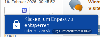

Hi there, i am trying out Brave browser on linux and osx, and find enpass not working.
It does show this:
but even with clicking on it it will not show anything other than that. the extension is installed and also connected to the enpass app. on firefox / chrome it works beautiful
any idea what to do?

Hi, thanks for your fast reply! I have tried both settings for Browser Authentication. but without result. here is what i mean.
it happens on all websites!
what i also noticed is that when i click on the extension button from enpass, nothing happenes. when i do the same on chrome / firefox it opens the small window next to the enpass symbol.
i use Brave Browser 145.1.87.188.
when i right click on the enpass extension, i can go to options end enable logging. here is what it sais:

This seems to me, that the browser addon is not authorized for the enpass app itself.
"18.2.2026, 11:37:41 : Authentication required"
looks as a clear indicator for me. But I'm no Enpass tech team, this is just my understanding. So I'd suggest uninstalling the addon, reinstalling it, waiting for the auth screen to appear and hoping for the best. Otherwise you'll have to wait for the support team.
  • Author
yes same for me. i have realized that after reinstalling on osx i have now a working enpass browser integration on brave, not on linux tho.
its ubuntu 25. any idea what i can do?
