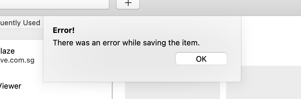

April 3, 20251 yr Hello team, This has been happening for the past at least three months on two of my Macs that sync to a WebDAV location. I noticed this a while back when NPaaS app was just in the background and running for a few hours, and then I would try to update it, it would give me this error. Then when I completely quit the app and open it again, it will allow me to make whatever change I try to do. As mentioned this happens on two Macs. Is this a known bug or issue? I've even tried to sync locally, and I have switched both of my Macs from WebDAV to working with the local file, but the same issue happens, so it's not WebDAV-related. Is there any log that I can share? I am running latest version 6.11.9 (1915). Best, Maik

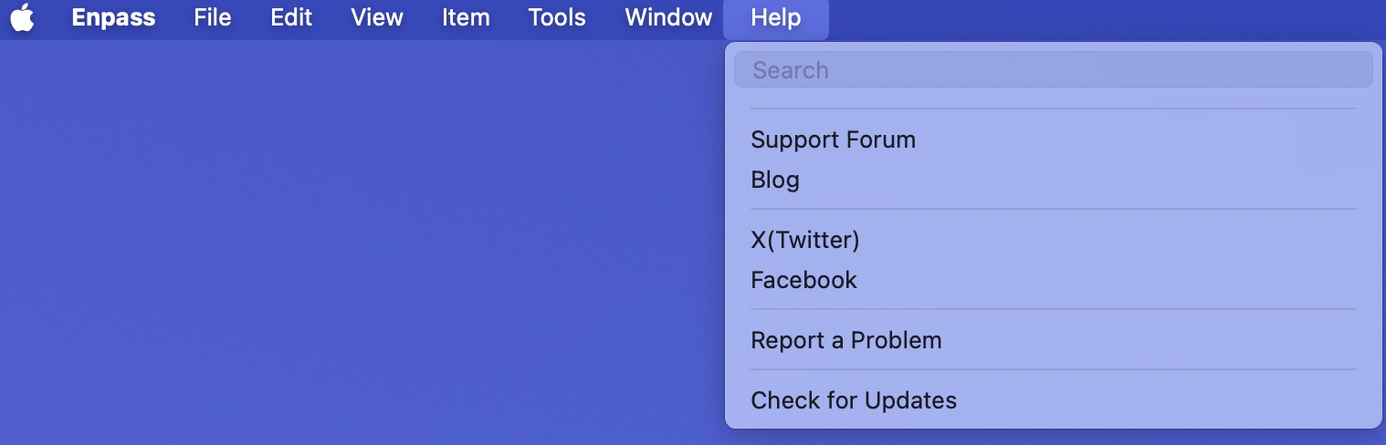

April 22, 20251 yr Author Hi, thank you, but there is no log available in the Help menu. I looked for it before, and I would have already sent it. Where can I find it ?
April 22, 20251 yr The logging option is available in the Enpass website version (downloaded directly from enpass.io), not the Store version. To enable logs: Open Enpass. Go to Settings > Advanced. Enable the Logs option. Once enabled, reproduce the issue and then send us the log fill, it will help us investigate further. Let me know if you need help finding the correct version or settings!

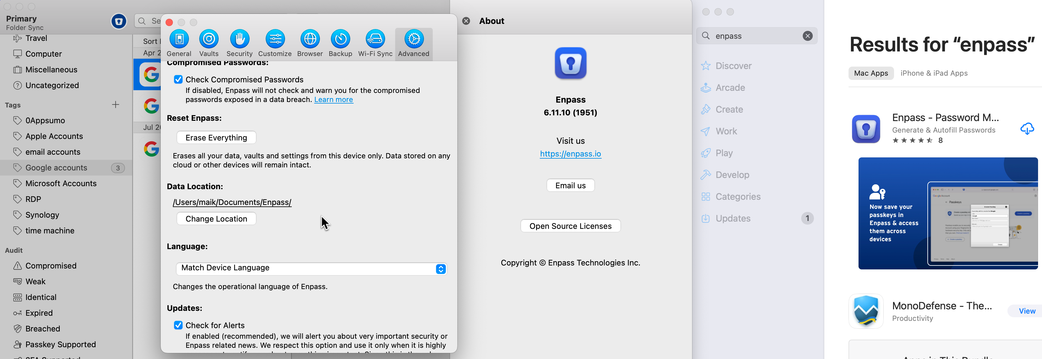

May 5, 20251 yr To help us investigate the issue, please provide the following details: Please confirm whether you have write access to the location where your Enpass data is stored. To check this, go to Enpass > Advanced Settings, find the data location, navigate to that folder using your file manager, and try creating a new folder. Let us know whether you're able to do so successfully. Are you encountering this issue with multiple items, or is it limited to a specific item?
May 6, 20251 yr Author Hi Team, Yes, I am using just a local folder: /Users/maik/Documents/Enpass/ I can read/write no issue. As mentioned Enpass can write changes for a while after I restart it. But it always gives me that error if I get back to it after a few hours. Have not yet figured out after how much time the error occurs...

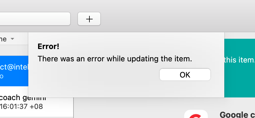

December 4, 2025Dec 4 Author Hi this error still happens daily on both my macs. behavior has not changed. After a while when enpass runs, any change attempt leads to this. I quit the app and run it, for a few minutes, changes are possible, then after a while the error happens again. Please please provide a way to support rectifying this. It is highly disruptive. Edited December 4, 2025Dec 4 by maik_is_here
December 8, 2025Dec 8 Thank you for reporting this — I understand how disruptive this issue can be, and I appreciate your patience. To help diagnose and resolve the problem, please try the following steps: Update Enpass Ensure you are using the latest version of Enpass on all your Macs. Recent releases often include important fixes. Verify App Permissions Make sure Enpass has full access to required permissions, especially storage and network access. Full-Screen Mode Check If Enpass is running in full-screen mode on macOS, please try running it in normal window mode and see if the issue persists. If the issue continues after trying these steps, please let us know we may need additional details to investigate further.
December 8, 2025Dec 8 Author Hi Team, Enpass is updated, it has even full disk permissions and is not running in full screen. Also: - I tried the app store version and the download version. same behavior. - I tried webdav and local. placed the enpass database in main user directory. same behavior. It's always the same...after a while of running the app, it throws this error. I have to quit the app then it it will work for a while, so it definitely is not related to permissions. Note this happens on both my macs..studio and macbook air m2. I am running latest 15.7.2. As you can see in this thread, this has been an issue forever. Is there any kind of verbose logging etc that I can provide that can help you diagnose this? I'd like to help to please get this resolved. It's very disruptive Thanks! 11 hours ago, Amandeep Kumar said: Thank you for reporting this — I understand how disruptive this issue can be, and I appreciate your patience. To help diagnose and resolve the problem, please try the following steps: Update Enpass Ensure you are using the latest version of Enpass on all your Macs. Recent releases often include important fixes. Verify App Permissions Make sure Enpass has full access to required permissions, especially storage and network access. Full-Screen Mode Check If Enpass is running in full-screen mode on macOS, please try running it in normal window mode and see if the issue persists. If the issue continues after trying these steps, please let us know we may need additional details to investigate further.

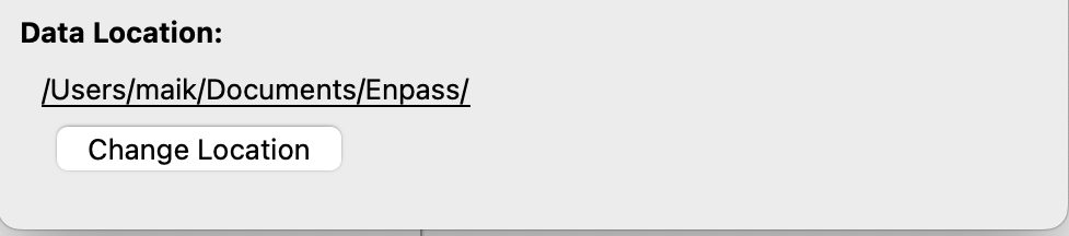

December 8, 2025Dec 8 Author FYi, my current data location is /Users/maik/Documents/Enpass/ and I run version 6.11.17 (2135)
