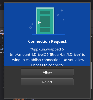

lmlmlm Posted June 16, 2025 Report Posted June 16, 2025 Another application, another connection request
Tarun Singh Rawat Posted June 17, 2025 Report Posted June 17, 2025 Our technical team is informed and is currently investigating the issue. We’ll update you as soon as we receive an update from them. #SI-3950
