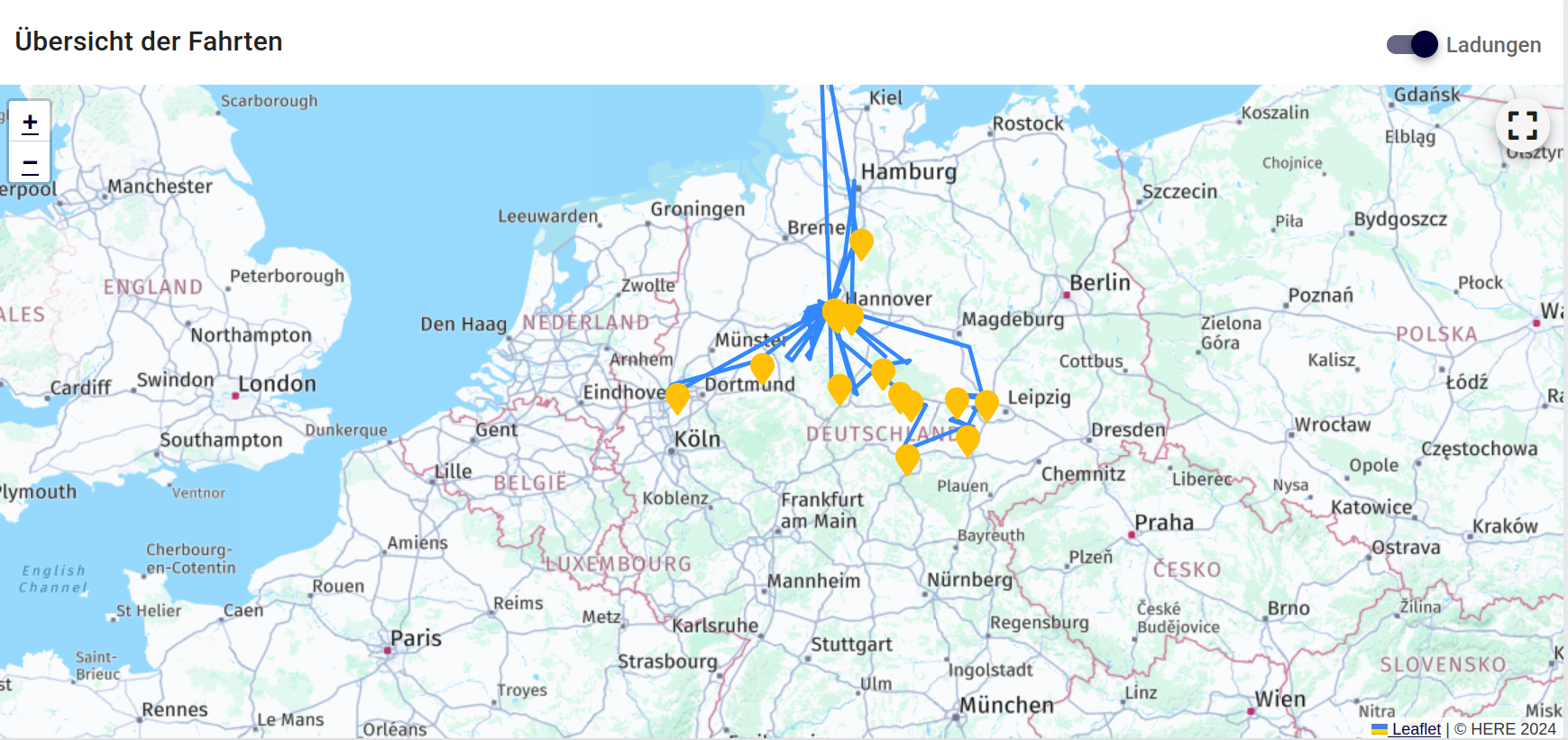

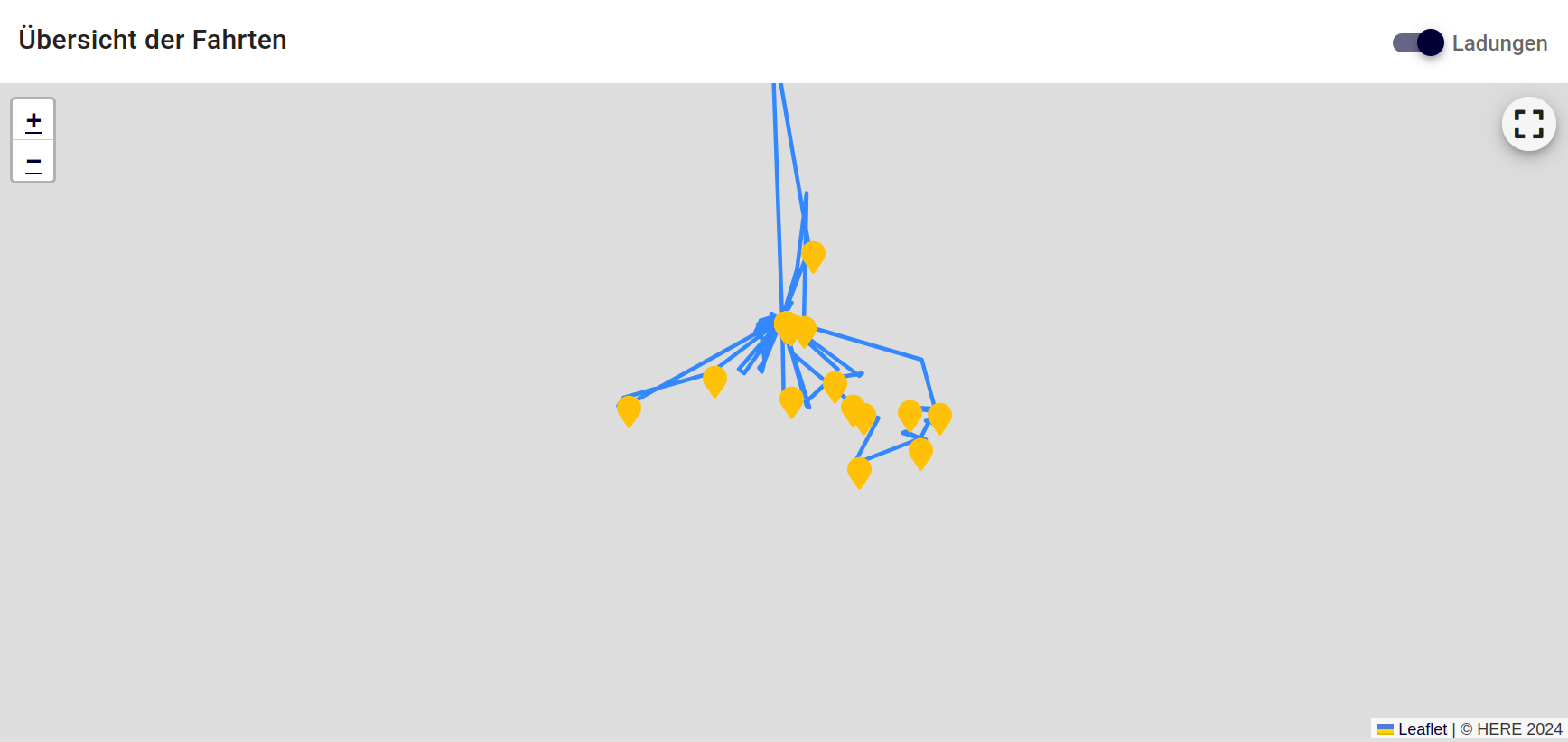

Oceanwaves Posted August 16, 2025 Author Report Posted August 16, 2025 (edited) Seems technical team is investigating the problem for more than 1 year now... Here is another website (https://app.tronity.io/dashboard) with a map that stopped working some days ago with the Enpass extension activated in Firefox 141.0.2. tronity.io is a website that records where my car is driving to and where I charged it. With Enpass extension 6.11.5.2 disabled everything looks fine: If I enable the Enpass extension the map is not shown anymore. I still can see that there are outgoing DNS requests for aps.hereapi.com, but the map is missing from the website: The interesting thing is that on Vivaldi browser everything looks fine, even with the Enpass extension activated (I tried Enpass extension v6.11.5 and v6.11.6). Would be nice if these modifications of websites in Firefox would be fixed. Kind regards, Oliver Edited August 16, 2025 by Oceanwaves

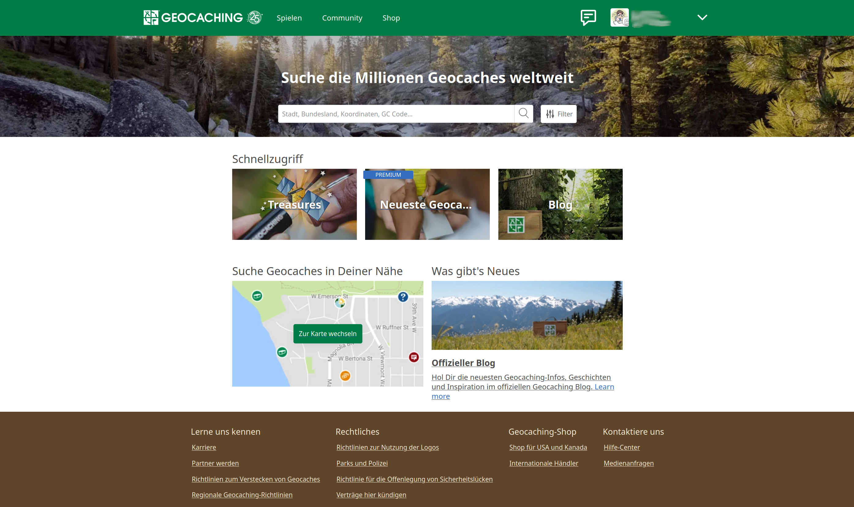

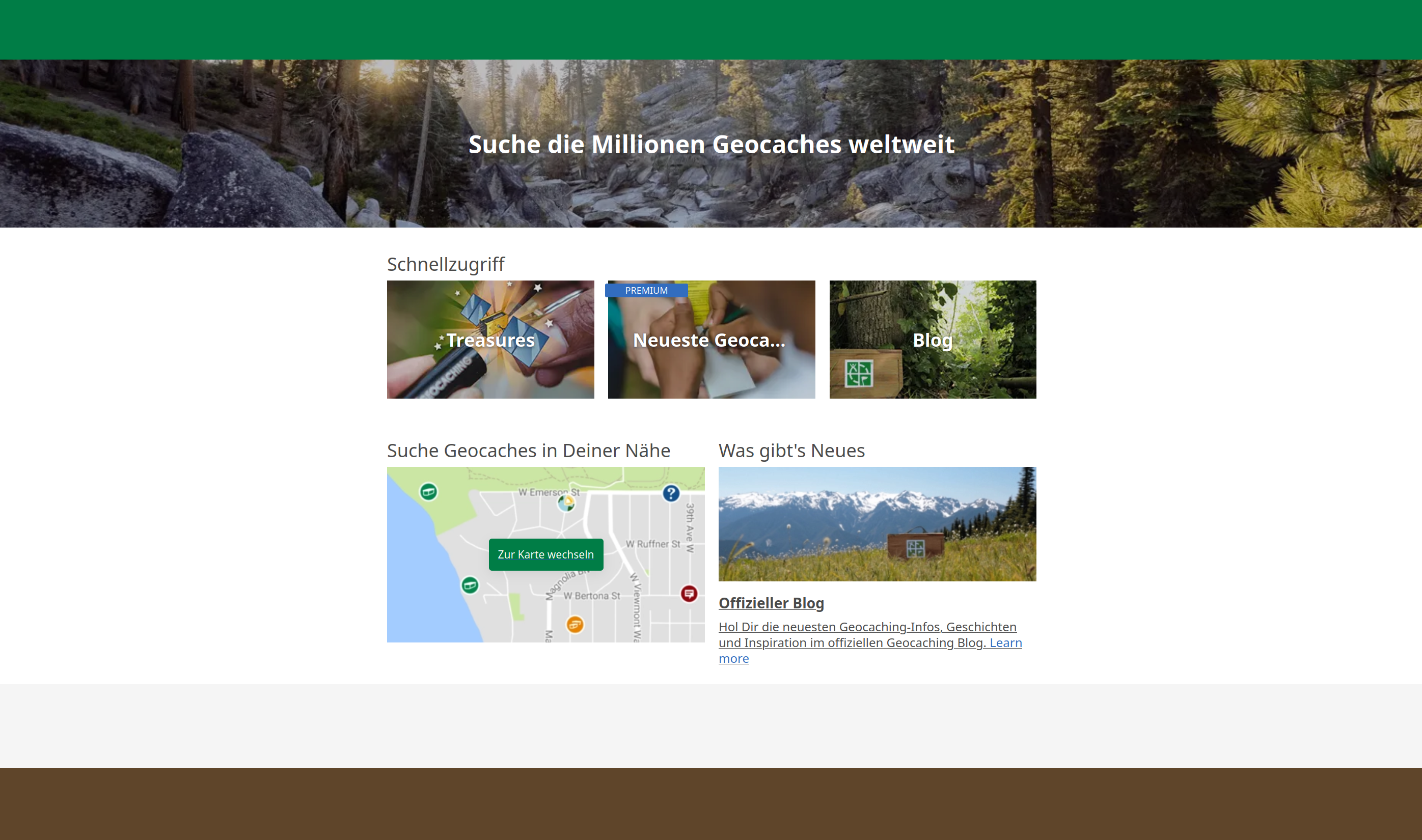

Oceanwaves Posted August 27, 2025 Author Report Posted August 27, 2025 I've updated to version 6.11.6.2 for Firefox. I can see the map on tronity.io again. But geocaching.com is still unusable. Without the options on the top green line I can't even open my account. Here are two screenshots. The first was taken with Firefox extension 6.11.6.2 enabled, the second one without the Enpass extension.
